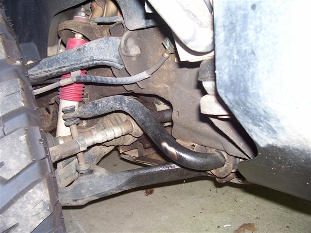

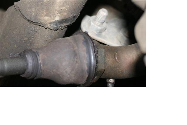

Since day one we've noticed some trucks exhibit more tire rub (in stock form) and some won't rub anywhere even after upgrading to 37" tires. I am running with a theory that some of this tire rub, severe toe in, front end problems, can be tied back to one thing on the truck. It might not mean very much except to those that wheel their trucks pretty hard and I might be way off on a tangent, but it has some merit (in my feeble mind anyway).
At your convenience please get your truck and straighten out the tires, and take a picture of the tie rods where they pass just under the frame. Do this on both sides of the truck. In your post, please also note any rubbing or front driveline/steering issues you might have had.
Here are two examples of the pictures I am going for:

pass side

Driver

Old 07-16-2006, 04:11 PM
Default Re: Need some help and effort
thanks BigZ, following my theory, yours is similar to mine and doesn't exhibit the problem I'm looking for.

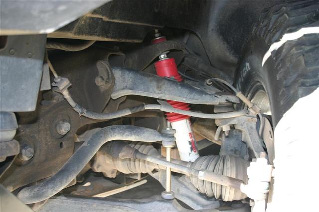

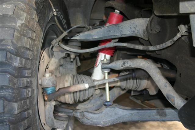

Here are mine. I started getting a little rubbing on the PS after tightening torsion bars. Not enough to notice from the drivers seat though.

Passenger side.

Drivers side.

Old 07-21-2006, 03:21 AM
Originally Posted by H2 Rocks
Passenger side.
Rocks, have Trent take a look at the frame rail just above the PS tie rod.
There's a good chance it shows some old rub marks where the centerlink and tie rod made contact.

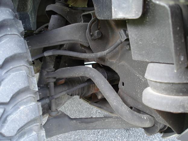

Ok. Here's a pic of the passenger side at a different angle. Trent said it has hit the frame before. The DS isn't as bad but has hit before.
edit; the wheels are straight in this pic
