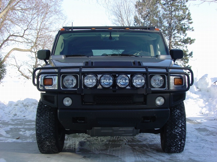

520 SMRs on the grill guard
http://www.elcovaforums.com/forums/a...5&d=1153332271
Old 07-28-2006, 12:28 AM
working Hummer's Avatar
Location: someplace crappy
Posts: 476
Default Re: Piaa lights?
Originally Posted by PARAGON
Now I don't have that cross bar you have yours mounted to. Will the lights bolt on to the grill guard where there are holes already? I'm only getting two of them.
Old 07-28-2006, 12:41 AM
Umm.... ya know. I can't answer that for sure. But the stock lights aren't very small, so I would have to guess that the 520s would easily fit.

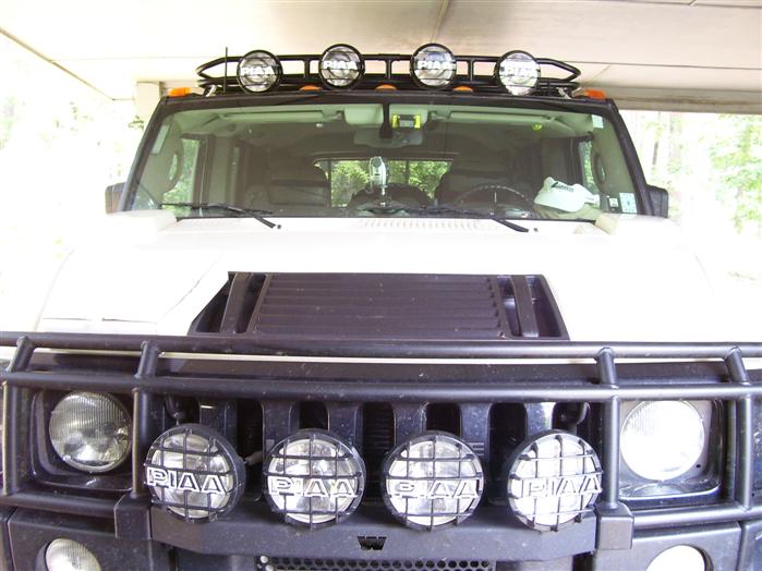

I'm not sure if your intentionally only considering the 510 and 520 or not. If not, I love my 580's. They're bigger, but they match the size of the headlights nicely. Plus they're very bright. Of course, they're probably more expensive. And I don't like the grids in the other models either.
If you go this route, get the driving lights. They're not to wide an angle and not too narrow. Aim them a little higher than your low beams. They're bright enough that if they're on, then you flip on your high beams you barely notice the high beams coming on.
I mounted mine on a Warn light bar. I'm not sure that they'll mount on the existing holes, but I think they'll fit. I included both front and side views of mine so you can see how they relate to the size of a double brushguard. They're rounded enough on the back that I bet they'll tuck between the lower and upper bars on the guard. The only issue I imagine would be bolt length, whether they'll reach through the brushguard bar (I don't know if you have holes in your bar or a clamp/tab). If that's a problem you could probably make some mounting tabs that would work.

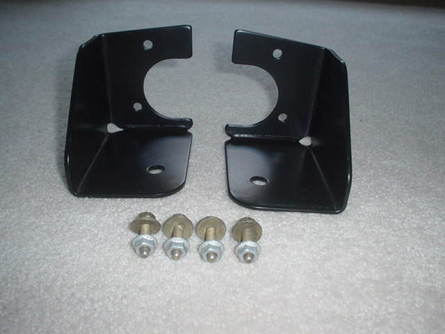

I believe you will need 2 of these brackets (attached pic) i dont think they sell them separately but the complete light kit part no. is 89006860.
I have a pair of these bracket sitting somewhere in the garage I will be happy to sell you

Yes, i found them. How bout $40 including shipping to South Dakota sounds to you?
Old 07-30-2006, 07:54 PM
Posts: 476
Do those triangular looking brackets just bolt onto my brush guard and the lights to them? If they are the right ones and you can get them here by Thursday you got yourself a deal I will PM you with address and let me know were to send check. Thanks.
Old 07-30-2006, 08:12 PM
Yes, they each have two tiny bolts that hold them and a large hole on top to bolt the light to.
