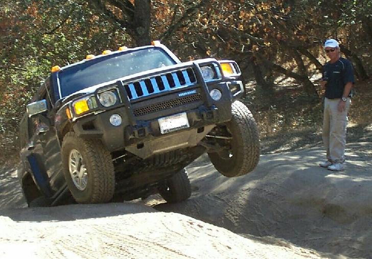

Here is where I was dubbed "Queen of no flex" by a yota friend. This is IFS.

Nice pic! The rear has very impressive flex.
