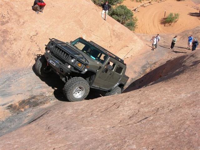

Default Re: Powdercoating stock grill
Originally Posted by 04H2
Has anybody powdercoated their stock chrome grill? New black painted one from the dealer is $500, was thinking that would be cheaper.
Bed liner works great.
Cool pic Ken.
