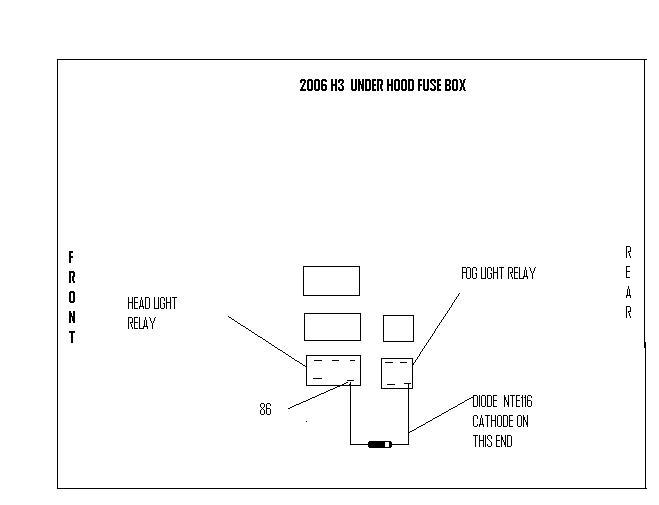

On the GM trucks we soldier in some diodes to have all 6 lights on w/ the hi beams.
Any one here checked or done it on the 3?
I get some time I'm going to try and get the fogs it to work.

Yes, it can be done, but could take some time to figure out. Both headlamps and Fog are BCM controlled.
BCM controls a relay to power the fogs, BCM controls the power circuit to the headlamps, and also controls the HI/LO beam relay to supply ground for the HI or LO beam.
Heading out of town, so I don't have time to really look right now.
Probably all you will need are some relays, maybe a few diodes, but you should be able to isolate the circuits with relays.

Dealer can't change it via software. Reason is, GM is following state laws. Most states require the fog lamps to dim with the HI beams, so they conform to state laws. (Not that the police ever enforce this law.)
As long as you isolate the circuits to prevent feedback to the computer, the only warranty you would void is the warranty for wiring you cut into.

NOT RESPONSIBLE FOR THE RESULTS OF THIS SUGGESTION
All it takes is a $.50 diode and they are done.
took a few minutes and found the relays and figured where to put the doide in.
no soldiering just pull the relay, insert the correct diode leg and reinsert the relays.
