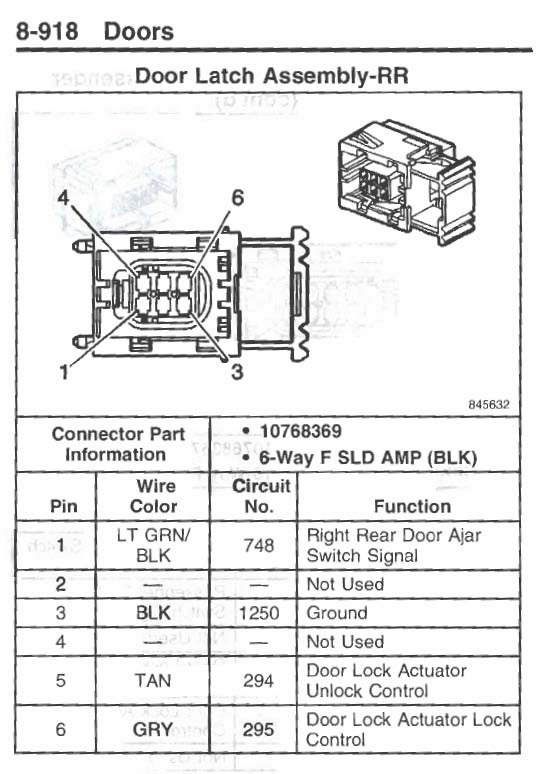

<BLOCKQUOTE class="ip-ubbcode-quote"><font size="-1">quote:</font><HR>Originally posted by partsguy:
The switch is part of the lock asm,but Ed
is right. by passing the switch will not over-
ride the BCM to air up the rear.
You need a new BCM.Where do you live? <HR></BLOCKQUOTE>That is if it is the BCM. A service tech would be able to determine where the problem is very quickly but the problem can be in a few places up and down the line. If is indeed the switch you can manually jump the switch and get the air bags up.
Ed might be correct as the BCM. If you can get to the connector, you can ground the proper indicator wire and see if it shuts off the door ajar signal.

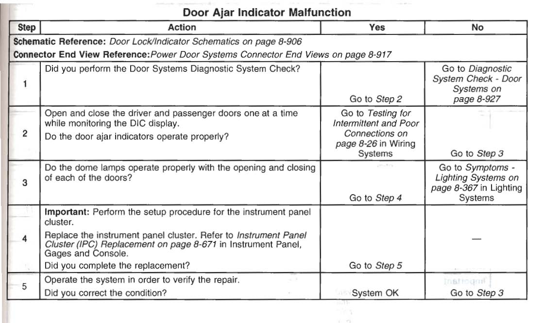

Old 09-03-2004, 11:44 AM
Here is something else from the manual

For clarification;
if its the switch I should be able to connect pin 1 and pin 3, to close the circuit and get the air bag to operate???
