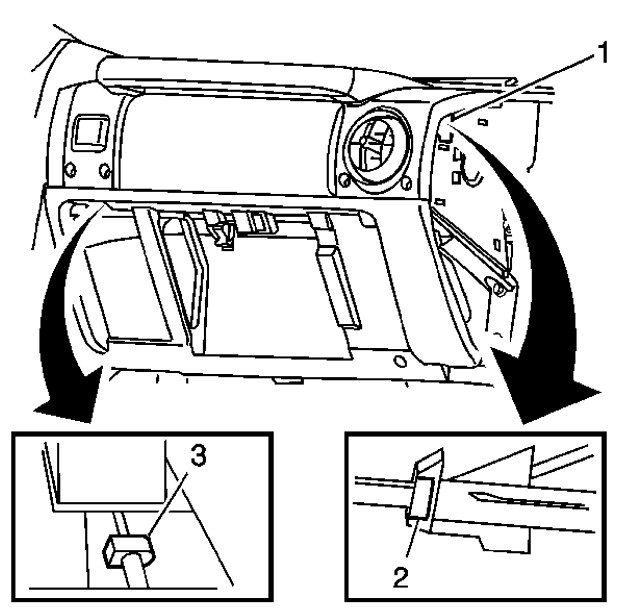

im stuck on the passanger side where you have the hold on bar just over the front air bag. how in the hell does that come off? im about to break the damm thing.

their are 2 little white buttons you have to push in one on each side ,you have to use a long screw driver to reack the one close to the door.you have to remove the side pannel to reach the one close to the door and the other you have to reach up though the glove compartment.. someone on here had a diagram its hard to explain without pics.. it is kinda a pain to get to them.. good luck..

Instrument Panel (I/P) Assist Handle Replacement
Removal Procedure
  1. Remove the passenger I/P (Instrument Panel) side trim panel. Fully open the I/P storage compartment.
    Important
    Both the left and the right assist handle release buttons face the outside of the vehicle. The release buttons need to be pushed towards the inside of the vehicle to release the assist handle.
    Using a long flat-bladed tool, through the opening in the I/P retainer (1) on the passenger side of the I/P:
    1. Push in on the assist handle release button (2) and
    2. Pull out on the handle to partially disengage the assist handle.
    Using a flat-bladed tool, through the I/P storage compartment opening, push in on the inboard assist handle release button (3).
  2. Remove the I/P assist handle.
Attached Imageshttp://www.elcovaforums.com/forums/attachment.php?attachmentid=21330&stc=1&d=11485842 55
It sounds as though you are there. Just take a long flat bladed screw driver and there is a slot from the outside that you can see into the metal rod that the handle is made to. There is a little metal clip type retainer that simply needs to be pushed lightly towards the driver's side.
Same thing on the inboard one but I think you have to come at it from inside the glove box area. You push in on the little white button thingys and pull out on the bar and work it out
