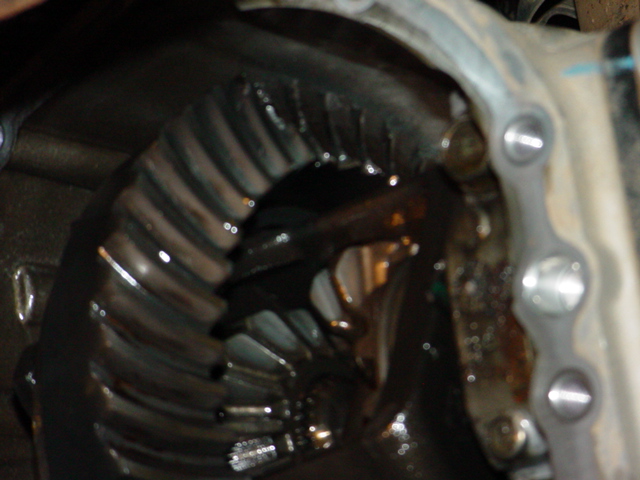

Here is what my first R&P looked like
overachiever
Old 09-26-2006, 07:35 PM
Default Re: Front Differential AND Driveline
ooooH That must have sounded bad...
"If your not breaking stuff, your not wheelin hard enough"
Bebes I think your wheelin plenty hard

Originally Posted by Sewie
overachiever
check this out , its mine from the same golden spike run
