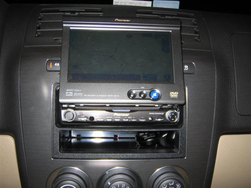

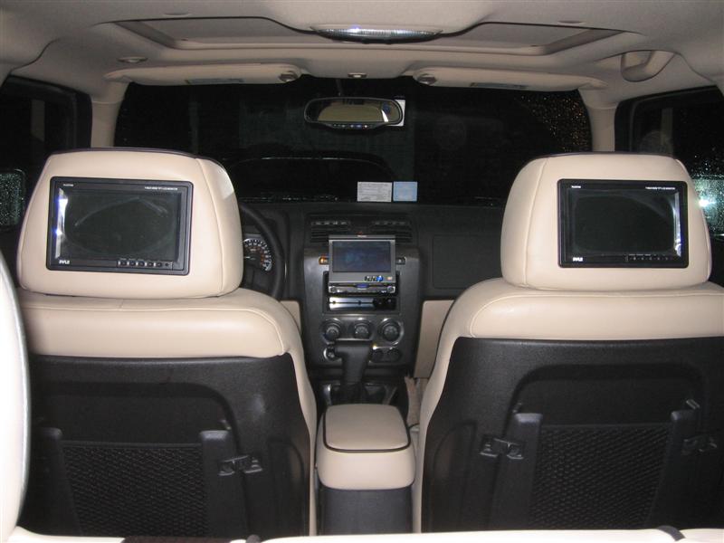

I finally got my AVIC-N1 installed last week. I used the Metra kit and it looks pretty good. I upgraded it to the N2 software so that I could also install NavTraffic. I also installed a set of headrests that I picked up on eBay. It goes in Friday for an amp, sub, and front components.

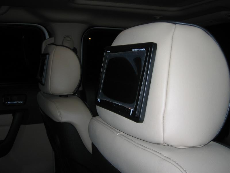

Another pic.

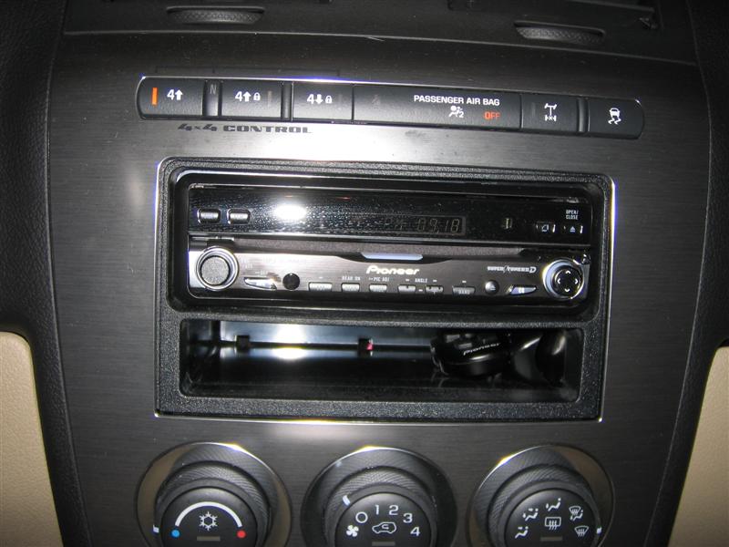

And Another

One more
