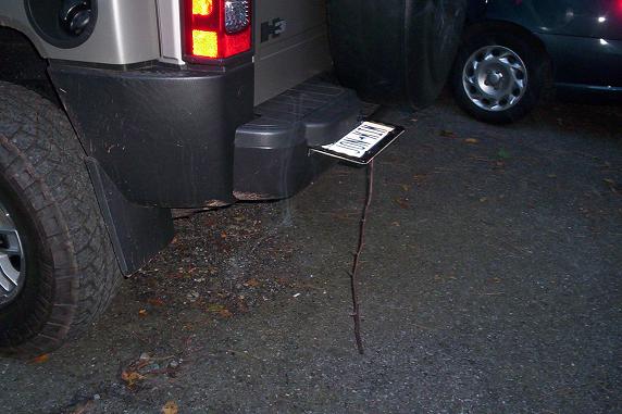

Old 11-07-2006, 04:44 PM
fourfourto's Avatar
Default Re: Rear license plate bends....
Just put a piano hinge on the rear plate ,easy install.

Old 11-08-2006, 01:13 AM
Posts: 1,326
Is that your kickstand?

Old 11-11-2006, 03:15 AM
Field Scout's Avatar
Field Scout Field Scout is offline
Posts: 232
Field Scout is on a distinguished road
Hinge didn't work for me, problem is when I came down slow on that corner it was like sitting straight down on the plate. after a day in Llano, Tx with the Hummer X club my plate looked like a rolled up newspaper

Old 11-12-2006, 04:49 PM
fourfourto's Avatar
Originally Posted by fw888
good idea, where you got the hinge at ?
My brother had a long piece at his shop.
Home depot should have it also.
I ended up puting a 1 inch piece of velcro on the ends and a 1 inch piece of interlock in the middle.It holds up at 90 mph but will hinge with a little presure.
Make sure theres a small gap on the hinge to fit the velcro /interlock in.
I used a stainless steel hinge .
Its been on for a few months its holding up well

Old 11-13-2006, 02:00 AM
fourfourto's Avatar
You put the velcro in between the hinges to hold it so it dont flap in the wind . you mount it with bolts.
link to install
http://www.elcovaforums.com/forums/showthread.php?t=19644&highlight=licence+plate+hin ge
