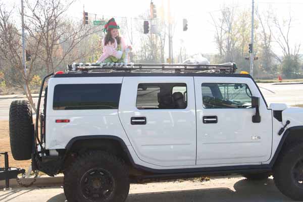

You can see how close the jack is here with my 18' enclosed, but it pulls fine and I don't have any problems except for not being able to open the rear hatch.
With my other trailers I can cut it just right to where I can open the spare tire carrier enough to open the rear hatch.

It's not the drop that's the problem, it's the location of the trailer jack where it hits the spare tire. Paragon knows what I mean and posted a pic showing how he deals with it.
Prior to Paragon posting his pic, I thought I was going to have to get a 12" extension tube. After seeing his pic, I think the Alumistinger will work or maybe the Hummer OEM extension tube which is only a 6.5" extension.

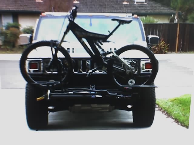

Back on post.....I only use my extension for my bike racks....I use it on the front and no need to clear the spare for the rear rack.....however, theres noway in hell I would use an extension for anything above say 500lbs....I would remove the spare if need be.
