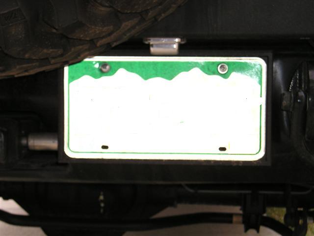

John, why not move your plate to the bumper. You can use your wires from your tire carrier. It'll take you all of 5 minutes to do this. PM me if you want pics and where I got all my stuff from.
11-27-2006, 09:22 PM
Posts: 1,369
Re: Can u beleave this?
i will take some pics
11-27-2006, 09:42 PM
It'll cost you.
Here's what you need.
Go to AutoZone or Checker.
You will need one license plate frame and one license plate light. (about $10.00). I mounted the light to the underside of the tire carrier with two self tapping screws and heat shrinked the connection also.
Than you just have to drille out two holes for your plate and bolt them through. I took some touch up paint wher I drilled- so no rust in teh future.
If you are going to remove the tire carrier you mount the light just above the your new frame too.
Since I wanted the 5th rim to show and didn't want the carrier sitcking through the rim, I just took the sawzall to it, grinder, and than painted it to match.
Here's a pic from the SUT I had. It the best pic I have of it mounted up close.
