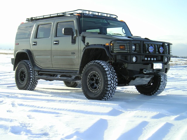

I'm still having issues for some reason with pulling into the garage.

Nice truck, looks complete!
