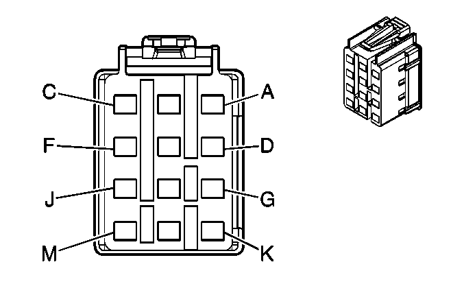

In the junction box on the firewall just to the upper left of the brake pedal, there is a green wire in there that has the backup POS signal.
It's in the C3 harness shown here. There is a little plastic nut you screw off and then the cover on the junction block pops off. Then you'll see what looks something like this picture:
Old 03-28-2006, 04:10 PM
In the C3 harness find the green wire and check it to see if that is your backup wire

Backup Lamp Supply Voltage</P></TD></TR></table>
Old 03-28-2006, 04:13 PM
Here is the plug from that harness

Thanks, saved me allot of time
