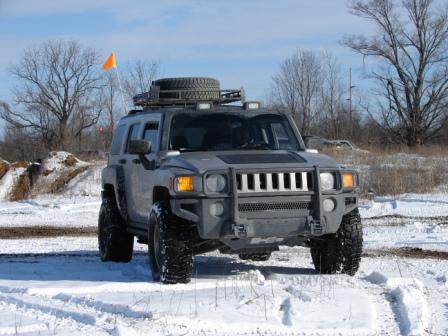

put the truxxx kit on last friday and took it out wheelin on saturday
It's easier to get forgivness than permission

I really like the American Racing rims you have on your rig...I was wondering, though, if the Truxxx kit is compatible with the stock rims?

Yes, the "kit" is just re-indexed t-bar keys and shock-extension brackets.
