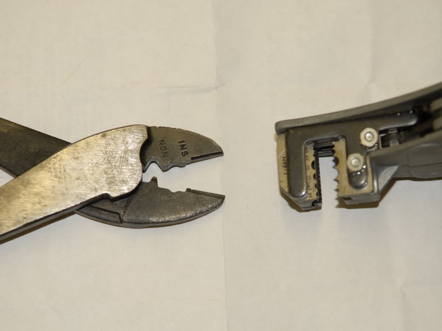

I got all kinds of crimpers but these on the left are best for these thin wires. The strippers on the right aren't cute but they are easier to do in tight places because they pull the end off for you. Im throwing all this out to help those that might not know all this so Im trying to be detailed. All you master mechanics can just grin. Oh and read the instructions. The ones plastered to the shrink wrap cardboard were x'ed out and there was a new sheet laying in the box. They must have changed something.
