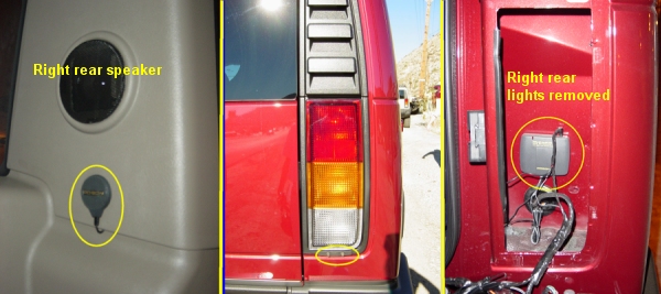

Poron comes in two models. I got the Micro 3 with Voice Distance Indicator (VDI). More info on the Micro 3 here
There's also the Mini 3 with LED display. More info on the Mini 3 here
Here's where I mounted the speaker, sensor and module respectively.
There's a predrilled hole in the rear right light housing. If you look underneath the right rear bumper under the right lights, you'll see a 1/2" hole which leads up to the inside of the rear right cavity. Inside the cavity is covered by insulation. Just run the wires under the rear bumper and up through the right housing.
I used wire looms to protect the wires underneath the bumper and also give it that OEM look as there are a couple of other wire looms under there already.
The speaker was just as easy. You'll see how to run the speaker wire when you look inside the cavity.
The tricky part was knowing how to remove the rear light housing. First remove the two star bolts. There are two clips on the outer side of the light housing and the only way to complete remove the housing is to slide the housing towards the center.

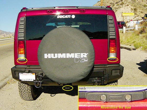

Here's the location of the sensors circled in yellow. The center sensor was mounted underneath the rear hitch. The kit comes with brackets, 3M double-sided tape and shims. The sensors on the sides have to be shimed to angle slightly downwards. The H2 is so high that it may not catch the bumpers of other cars unless it's angled downwards a bit. The hitch was low enough that I can just angle the center sensor perpendicular to the hitch.
Like I said, once you have this device, I don't know how I did w/o it. Actually, I didn't. Before the sensor, when I thought I was REALLY close to the car behind me, I had like 4' to spare. With the sensor, I can get as close as 2' w/o any worries.
With the tire carrier, don't forget to subtract 1 foot from what the computer tells you. (i.e., 3 feet actually means 2 feet since the tire sticks out about a foot. For those w/o carrier, the distance should be true.

NSTXC, Very cool install. Tell me more about the sensor on the hitch. Did you just stick the sensor on the face of the receiver or did you use some kind of bracket? Can you still use the hitch? Did you consider installing the side sensors on the plastic bumper to get them down lower? Sounds like you're happy with its performance. Any other comments?
Thanks, Ted
Mango -- Saltwater Flyfisherman, Photographer, Varmint Hunter -- Fort Worth, Tx
"They that can give up essential liberty to obtain a little temporary safety deserve neither liberty nor safety."
\"They that can give up essential liberty to obtain a little temporary safety deserve neither liberty nor safety.\"
Old 01-26-2003, 02:57 AM
NSXTC NSXTC is offline
Location: San Diego, CA
Posts: 143
NSXTC is off the scale
The kit comes with 3 brackets which can be adjusted to any angle. You can still use the hitch. However, since the H2 is so high, most of you will probably use a lowering tongue. In which case, the center sensor will immediate go off as soon as you put it in reverse. I asked Poron if you can just use two sensors and as long as you make it equal distance from the center and at most 12" from the sides, you're OK.
If you use two, then I don't know where you would mount the sensor. Especially if you have a tire carrier.
I originally thought of mounting the side sensors in the square groove, but that means you would need to drill the bumper.
Believe me, I spent hours trying to find the best location and this is what I came up with.
BTW, the wire for the side sensors simply were tucked behind the bottom of the light housing. No drilling. Just be careful and don't pinch the wires where it would get cut. To be sure, I wraped the wires where it got tucked with electrical tape thereby giving it a thicker insulation.
