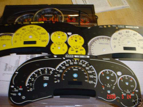

Default Instrument cluster face plates for sale.
I have Yellow, silver white and black. Here is a pic. Send me a PM or email your offer. monsta_dodge@yahoo.com

How hard is it to change them?

you have to take off the dash panel covering the gauge cluster. then remove 4 bolts holding the cluster onto the dash. then there are clips that hold the clear plastic to the cluster. I would recommend you draw a cluster on a piece of paper then draw where the needles go to use as a reference. Use a small screwdriver and carefully remove the needles. or, if you have the tool to remove the needles that would be better and faster. (it looks like a small prybar.) Just lift the OEM face and put the new one on. Then use the drawing you made to put the needles back on. Then reverse the process.
I think you can get the go to the NU IMAGE web site and get install instructions. Or do a search.... It takes about 1.5 hours if you have to have it perfect. But the results are awsome.
