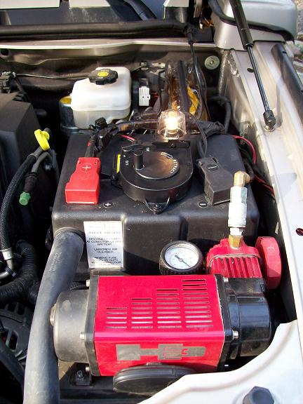

You should carry your own compressor as a back up
I also carry a extra air hose,at the beach they only supply 2 air hoses.On a busy day there is a line ,they provide apx 8 more air supply locations to hook your own hose to.The one I have has a lock to keep it on the valve and also a built in gauge.
Think about installing a compressor under the hood.The masterflow will air up from 18psi to 35 psi under 2 minutes a tire.
Easy install  use search for install pics and info.
better safe then sorry
Awesome set up 442! I like the compressor set up myself. Save the hassle of filling up a CO2 tank every other time you wheel. Although having the ability to reset a bead is nice with the tank set up. On my old heep I had a custom front bumper that held the compressed air from the compressor and a air port on the front for easy fill up. that gave me the extra capacity to run air tools, and whatever else. Kinda cool idea until it gets pierced by a rock. boom! Definately a plus to be self sufficient and not have to worry about finding a gas station.
442: could you possibly link me to where you picked up your compressor?
You can get one at Pep boys or on ebay
install link below. Some of us  did a slightly different install on the remote hose conection
http://www.elcovaforums.com/forums/s...ght=masterflow

Re: Trouble airing back up? TPMS info inside!
Thanks brudda!  What are the effects if any of mud on the compressor? Is everything sealed pretty good?
Edit: Shower caps, got it!

I got a small one that fits in the rear cubby area for 79 buks at recovery.com or something, I have to use it eveytime. almost no gas stations offer or have functioning air compressors in this area. Look for one that posts inflaction times I can air up all for from 20 to 30 in aobut 12-15 minutes.
I have that compressor but have a question...
What do you think the long term effect will be on the compressor from the heat generated under the hood?
