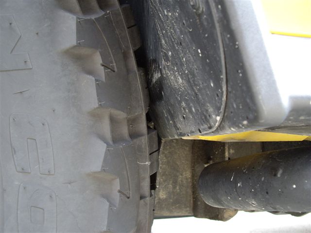

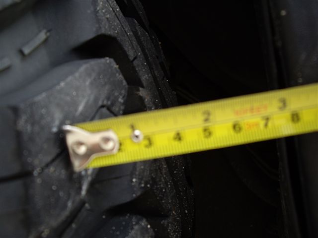

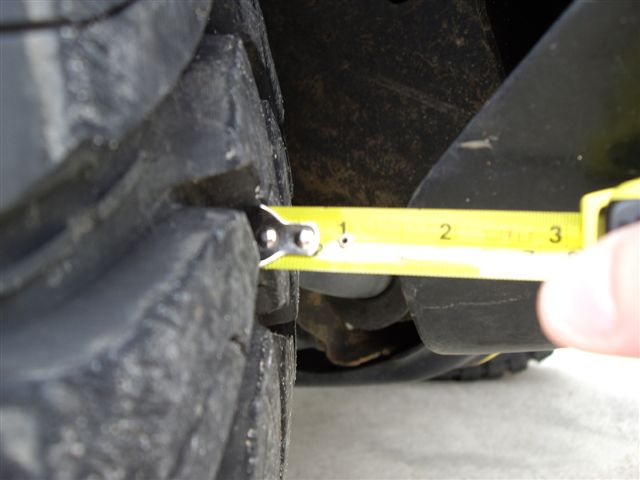

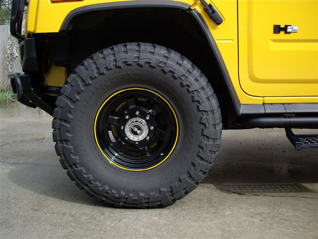

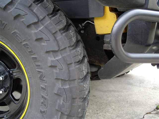

I've got some aftermarket wheels that are 17x8 -6mm and pretty sure they're 4.5in backspace. Running 37 in Toyos, no lift or t-bar adjustment. The rear if fine, perfect spacing out w/-6mm from rear air height sensors. In the front rubbing occurs at full turn against the back rubber. Very minor on pavement (bump and brush going over driveways), a good bit more on extreme angles off road. Even at full turn the front still has about 1.5 from the front bumper lip. Here are a few pics, hope this helps:

If you put those tires on the stock rims you'll do ok. on after market rims the back spacing pushes the tire and rim outward causing it to rub on the inner fender, try using a heat gun knife and 5lb sledge to gain some extra clearance.
