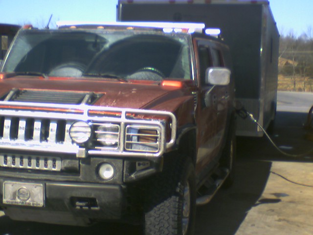

Just got back driving in the snow from N.C. to Calif. Pulling my 32 foot trailer That's salt all over the windshield

It's a great tow vehicle!
