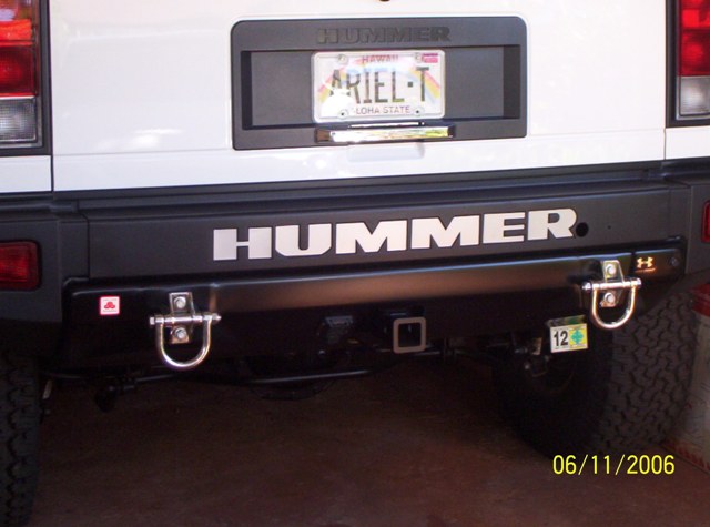

here is what i did with my 06 H2 SUV coz i also like the look without the rear tire carrier and spare tire in the back...bought a set of SS rear tow hooks from Realwheels...i was going to cover the hole where the word HUMMER is but decided not to...for the rear license plate, i drilled 2 holes on the rear license plate mount (black piece)...no need for the plate lites during the night!!!!
Why not? Doesn't the stock rear door plate holder have a light on it? I'd assume you'd need to add the plate light to your modified plate holder as well.

i believe 2006 H2 SUV models has no lights pre-wired for rear license plate holder....
