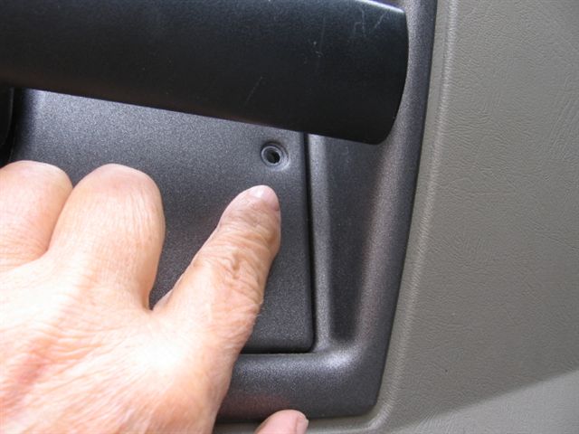

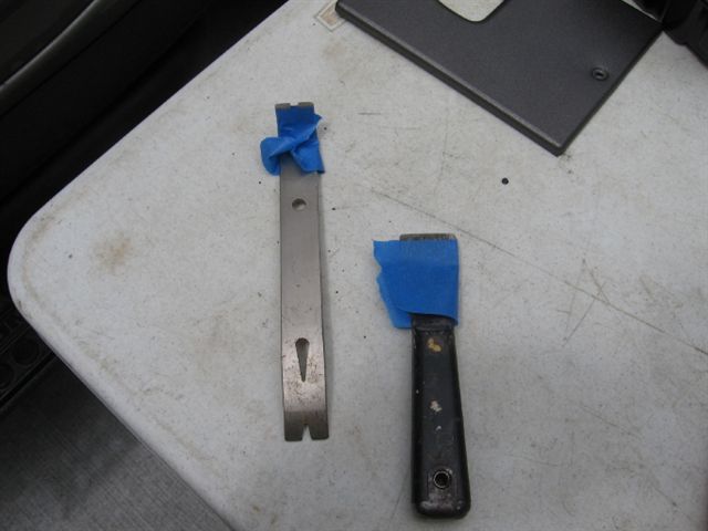

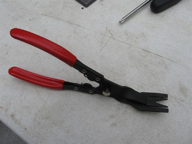

There are really only several tools needed to make the change. Phillips screwdriver, 7mm socket, 13mm open end (ratchet box end worked better) a stiff putty knife or two and a small wonder bar. There is also a tool that I will show a picture of that costs about $20 that pops the door panel retaining clips off with out damage. I also wrapped the putty knife and pry bar with painters tape to avoid scratches to the paint.

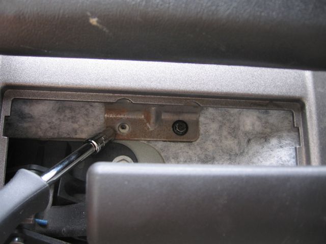

First remove the door bezel Phillips screw.

Pictures resized, so can move forward. Phillips screw (1) comes out first.

Once the bezel is removed, then there are two 7mm hex head screws that need to be removed.

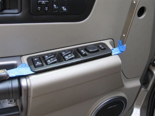

Tape the putty knife and wonder bar to avoid scratching things.

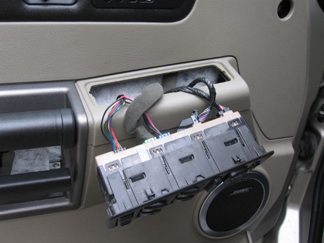

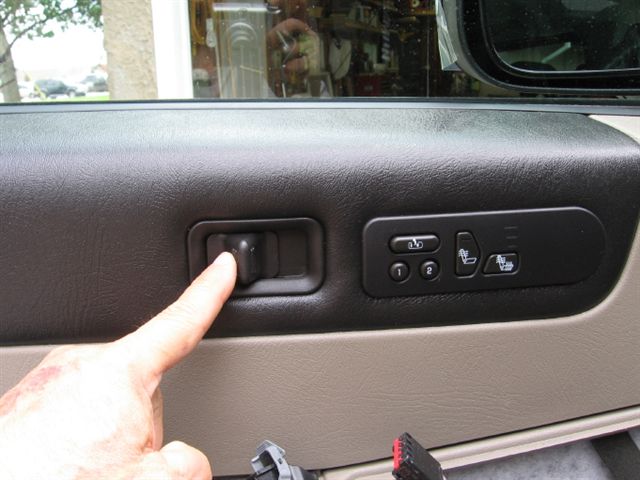

This next part is rather stressful. With the putty knife and wonder bar pry the power window control group loose in the door panel. Keep working it around, it pops and cracks but will come out safely.

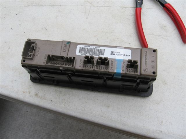

Every thing in the door (electrical) plugs in to this panel except the courtesy light. Work the plugs out, they have little latches and the panel is marked to easily replace the plugs when you are done.

Window control panel with plugs removed.

This is the slick panel puller tool. Well worth the $20 bucks.
Note: Put painter's tape on the back of the tool, it will be pushed under the door panel to pop the door panel off.

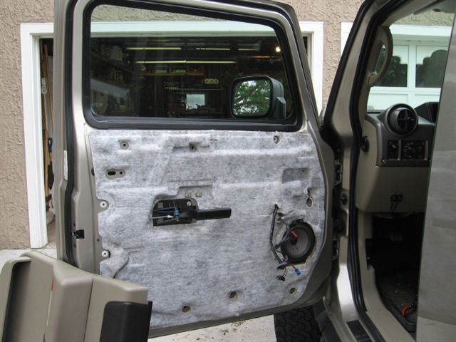

Once the panel is poped of, you will find only one wire attached, the courtesy light. I just twisted the panel around and leaned it against the door.

The door is covered with a water liner the upper right corner in the picture, needs to be peeled back, I cut the glue with a utility knife......about 12 or 14 inches each way from the upper right corner.

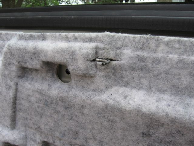

When you get the water liner pulled back.....I secured it with a long piece of panter's tape down to the bottom of the door to keep it out of the way.
Pull the clip that secures the mirror wire to the inner metal liner of the door after pulling it through the water liner.

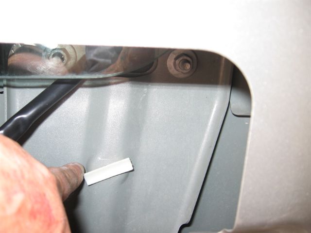

First clip to slide off the door to start to free the wire.
Old 06-01-2007, 02:59 AM
lvmyhmr lvmyhmr is offline
Location: Nebraska
Posts: 56
lvmyhmr is off the scale
Default Re: Quick and easy H2 mirror change
The second retractor clip is plastic and you can slide your hand in and release the wire from the clip without pulling clip loose from the body. It snaps open like a door to free the wire.

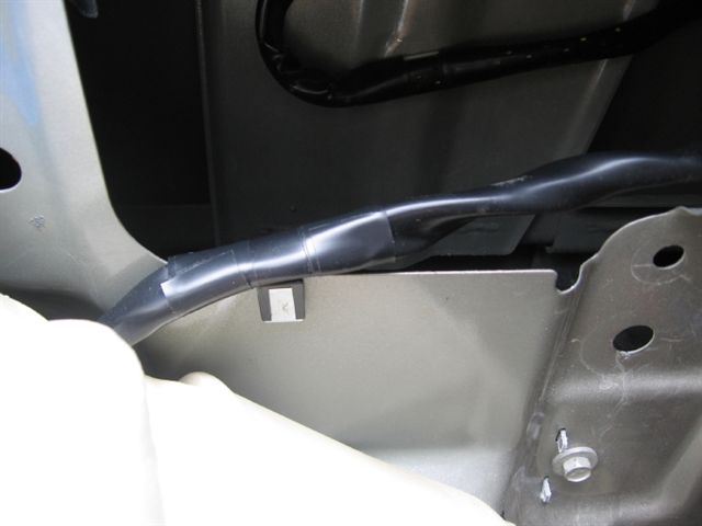

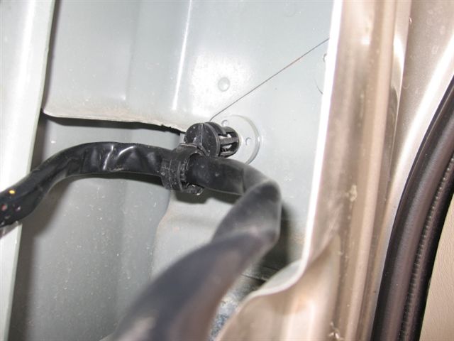

The last wire holder is a push in "T" type that looks like the wire is taped to it. Pull on both sides of the wire and it will slip off. When you replace it later, fold the top of the "T" together and slide the tape back over it and it will hold the wire.
These steps are important, notice that all of these clips keep the wire for the mirror clear of the power window. Need to be award of that and make sure it is clear when you re-install.

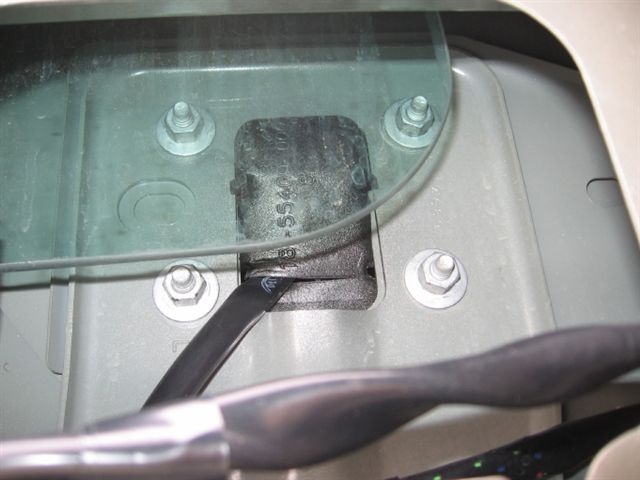

Next use the 13mm box end rachet wrench to remove the nuts that are behind the glass. The studs have a starter section and do not fall off. Small hands like mine do not hurt this situation. Remember only the three nuts behind the glass.
Get a helper to support the mirror, and then remove the final nut, then the helper can keep the mirror from falling and scratching the paint.
