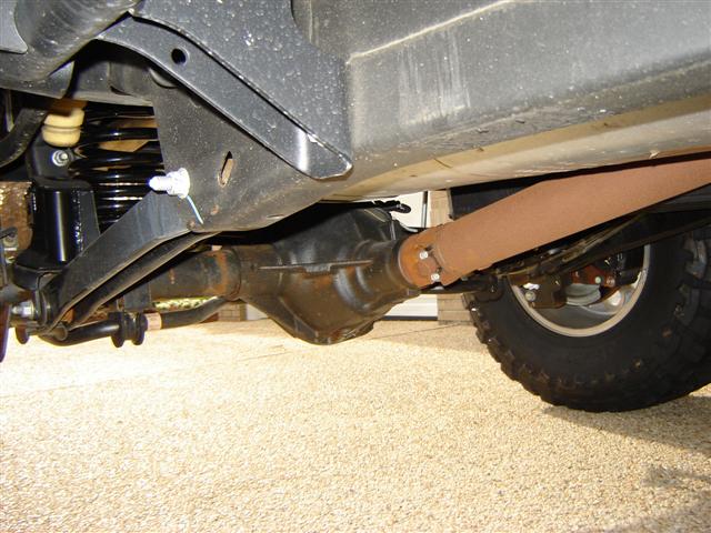

Is it possible for anyone to take a sideview pic of their rear differential showing the angle of the driveshaft coming out of it?
After all the work I've done, I still have a very minor vibration. Though the rear diff shouldn't have to be adjusted or shimmed with the lift kit, I swear the rear driveshaft has too little pinion angle.
Anyone willing to take a pic for me? Preferable one with a liftkit...

Here's a pic of mine... notice the lack of pinion angle?

Old 12-09-2005, 12:01 PM
Dan Dan is offline
Location: Cognito
Posts: 2,155
I dunno, that angle doesn't look bad at all. I've seen worse. If you don't have vibration I wouldn't worry about it.
Unless its worse than the pic portrays?

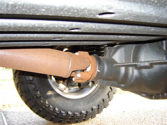

Old 12-09-2005, 06:16 PM
Pic one
Old 12-09-2005, 06:17 PM
Pic two
Old 12-09-2005, 09:17 PM
Location: Charlotte, NC
Posts: 2,767
Ken,
Thank you so much. I just realized what my problem is. I have too much pinion angle. There shouldn't be more than .5 degree difference between front and rear pinion angles on the same driveshaft.
I thought I didn't have enough. After stopping at the local Hummer dealership today and looking now at your pics, I see that I have too much. Isn't that wierd? I wonder why mine would have any more than anyone else's?
Nonetheless, I had the driveshaft shop make up ANOTHER driveshaft except as Beastmaster even suggested, I had them make it up with a CV joint style driveshaft.
Thanks for the pics, much appreciated.
Mark
Unless its worse than the pic portrays? </div></BLOCKQUOTE>
Dan,
I agree. It doesn't look bad at all. The vibration is driving me nuts. With the stock driveshaft I had a TERRIBLE vibration at 80-90 mph. I mean it would shudder the entire undercarriage.

Old 12-09-2005, 11:22 PM
Mark, professional intall was $600.
Phil, it looks like you have oil up under there.
Phil, it looks like you have oil up under there. </div></BLOCKQUOTE>
Ken,
Yeah, yeah, yeah...lol. you keep preaching that but I hate to tell you this but my situation has nothing to do with professional or otherwise install. I've simply got one of those trucks that has a problem. Not any different than when someone says what a POS their vehicle is because they happen to get a lemon. I just happen to have a quirk that I haven't figured out yet.
If you installed your kit, you'd know that this kit is ridiculously easy to install. It's time consuming is all.
I honestly don't think you can screw up the install of this kit barring forgetting to tighten up bolts, cutting the wrong tab off the front diff, etc, etc.
And just for the record, I've had 3 companies that install liftkits and one driveline company check my H2 out. They can't find an answer to my problem neither.
Back to the drawing board.
Thanks for the pics btw.
Mark
