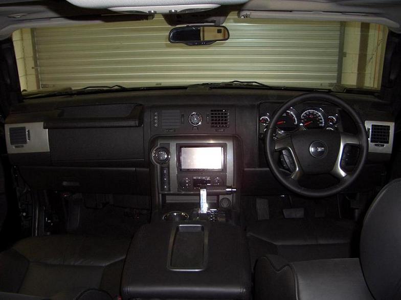

PS here is a pic of a RHD H2 it took 6 months to finish

hahah that looks odd seeing it all reverse.
