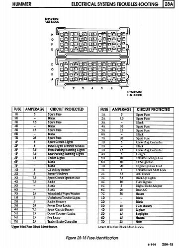

i'm trying to replace the cigarette lighter fuse, but i don't know which one it is. i have a 94 h1 soft top...anyone know which fuse it is. i have two fuse boxes

On A 95 Model year it is fuse 3d, as far as my manuals go back. Which if I remember correctly is bottom panel, top row 3rd from the left. A is the very bottom row and h is the top I think. Should be A 10a fuse.

It is 4D for the 94 model. Lower panel, center column, top row.
