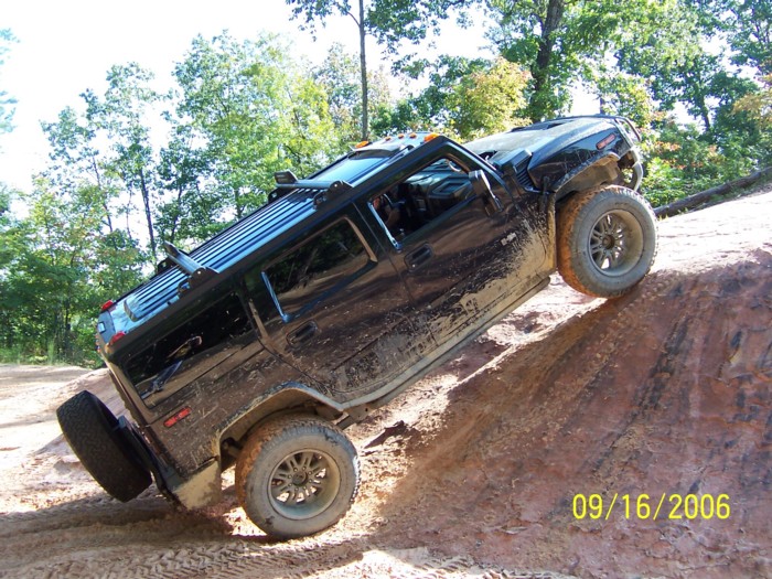

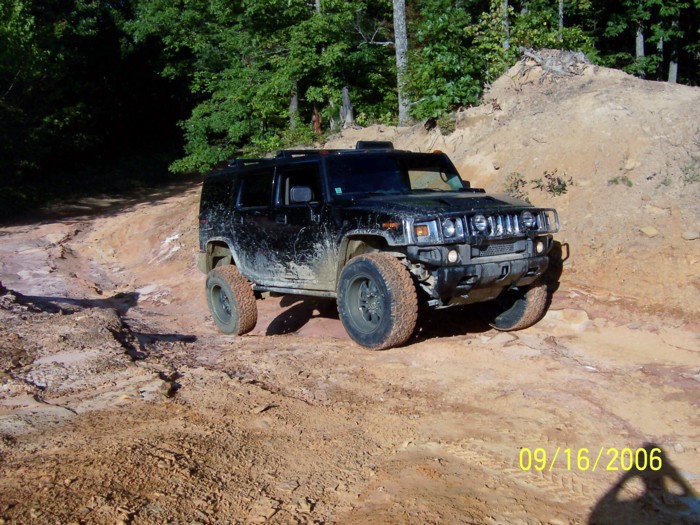

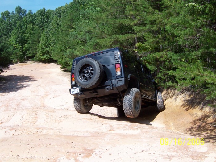

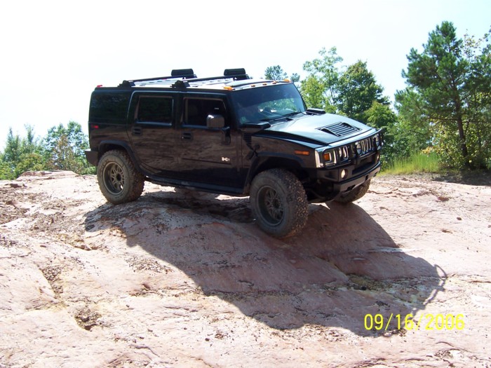

Here are a couple pics of mine. The rims are 20x10 Eagle Alloy Series 114. The backspacing is 4 5/8 and the offset is -21mm. The tires are 37x12.50 BFGoodrich ATs. I?ve had ?em flexed pretty far and haven?t ripped out any wheel liners yet?

another...

again...

last one...

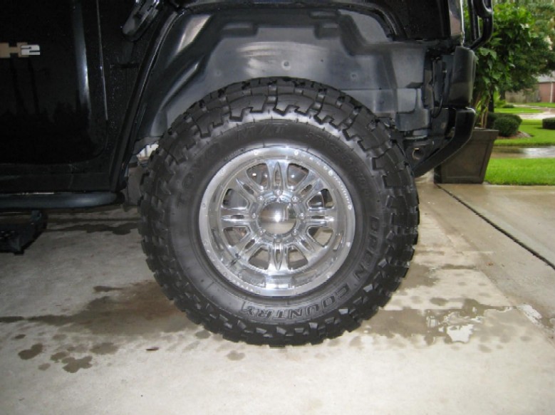

18x10 with 4.5" backspace, not sure of offset, 37x13.5 Toyos. Torsion bars are cranked such that the truck sits close to level. When I was running Nitto Muds with the same wheels, the fender liner was getting chewed up, so I just cut the bottom 4-5 inches off the liner. Since the Toyos have a more rounded profile, I don't think they'd have rubbed so badly.
