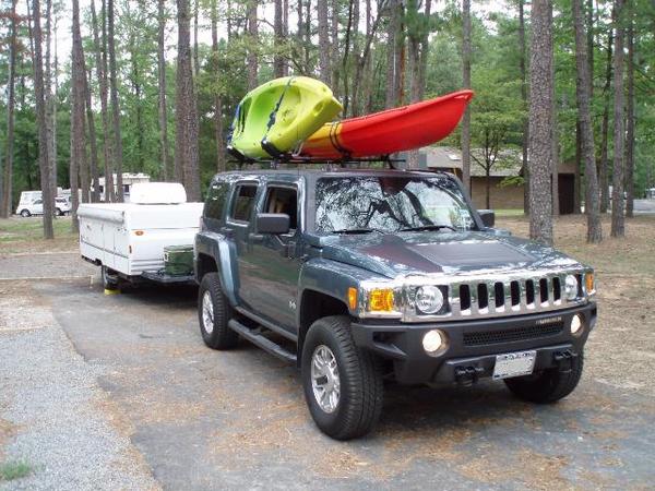

Originally Posted by ChiHummer3
What are the straps that you are using to secure the front and rear of your kayaks?
Here are my kayaks on my '06 H3 with the Thule racks and attachments. I still don't have any pics of my '07 with the Aries racks yet. One of my kayaks is a 2 man and weighs about 65 pounds. I'm not sure of the weight limit on the Aries racks.
Those are Lasso Kayak Locks that are looped around the yaks. I put them on there not so much because I thought the kayaks would go anywhere when I we were driving - but because I don't want anyone stealing the yaks (or the Thule racks for that matter) if we parked anywhere for more than 5 minutes. They ain't cheap, as I'm sure you know!
Hey - have you figured out an easy way to get the straps on the Thule (Hull-a-port) once the kayak is in the rack? The darn yak stands so tall once it's in the rack that ya really need a ladder to get the straps on there properly. And I'm pretty tall. If you've got any tips for me there, I'd appreciate it!
The weight limit on the OEM racks is 250lbs. I would think the Aries should hold a comparable load - so you should be more than fine with the 2 man, and then some.
