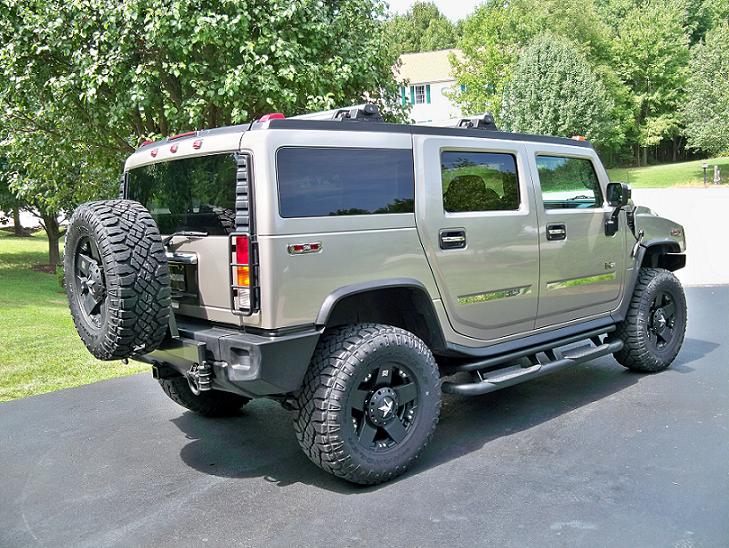

Or you could buy a more reasonable size wheel and tire combination 18x9 Rockstars - LT325/65R-18 Goodyear Wrangler DuraTrac
