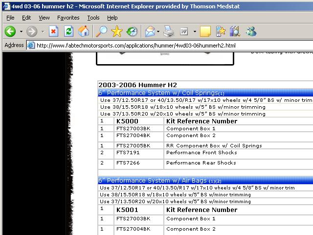

there is 2 diffrent kits, one for spring and one for air.
make sure you order the right one.

as i said there are 2 part numbers, it dosent take but a sec to check.. from fabtech site
