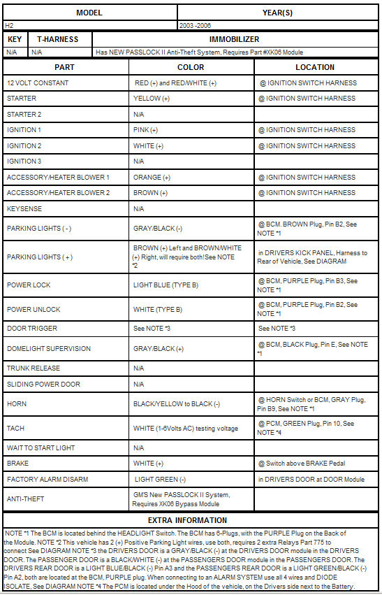

Just curious what alarm system most of you guys are using. I'm looking for of course a good quality system that can't be disarmed by merely cutting the power wire to the battery (just in case the truck is broken into and the hood is popped.) Any help is greatly appreciated....thanks....Jamie

Just installed a Viper 5900 SST on mine a few days ago and love it. Remote start is nice on hot days. Locks and arms automaticly so I can never forget. They make a addon battery backup module for battery cutting protection.

Did the install myself, i'v done quite a few,and I dont like others messing with my wiring. If you plan on doing it yourself I can post up the wiring for the truck. I also have a spare Passlock bypass module I'll let go cheap, you will need it if you want to do remote start also makes the door locks easy.

Please post up the wiring.

Default Re: Alarm question
here ya go...

here ya go...
Thanks man....
