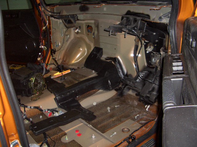

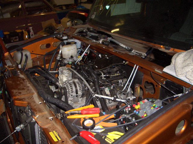

i am currently converting my second H2 to right hand drive, here is Australia, it is a brand new (yes it has taken this long to get it here) 2006 fusion orange limited edition. i am nearly finished the RHD conversion and hope to have it on the road next month.

PS here are some pics of a new h2 cut up
