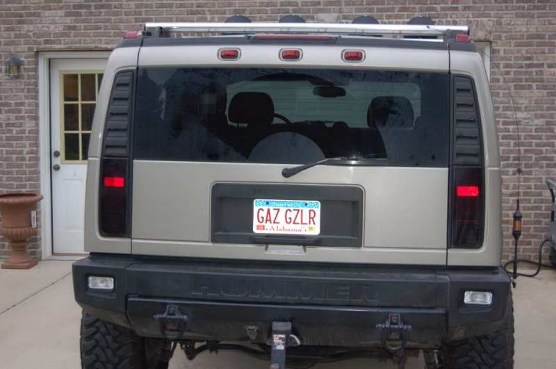

I added the Delta reverse light kit. They are bright as hell. I tented my rear lights so my reverse lights were dismal. The delta lights are nice and they fit in the bumper valance. From what I heard (but have not confirmed) these lights fit real nice in place of 2005 and newer bumper brake lights. When I installed my deltas the only pain in the butt was cutting the holes and making them look nice. I ended up buying some black door edge molding and covering the entire area that I cut. You can pick these kits up for less than $100. Hope this helps........

I did the same as audiofetish. They work real nice....as stated, cutting out the holes was a bit time consuming but a good dremel tool helps out with this.
