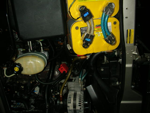

Does anyone here know who has this dual battery setup? Battery size? Is the stock battery tray used?
I like this setup except I would want to use an isolator so that I can save one battery for emergency starts. Anybody have info on this pic?
I think I found it by using the term "best battery" in the search feature.
That's my setup/pic. I wish I had answers to all your questions. I picked up the truck a week ago. The preivous owner had installed the dual yellow top setup. I'd be happy to take more detailed pics if it would help in determining what he did. I'll give him a call tomorrow and see if he can give me more information.

Seems to me like a custom setup i doubt they sell a kit for 2 optima batteries....
Im going with one Optima Yellow top for now and dual alternator setup....maybe a second optima if i can fit it somewhere...
