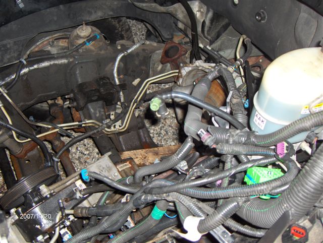

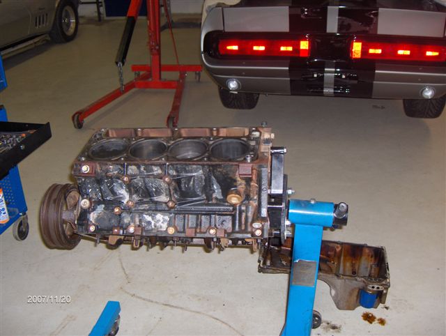

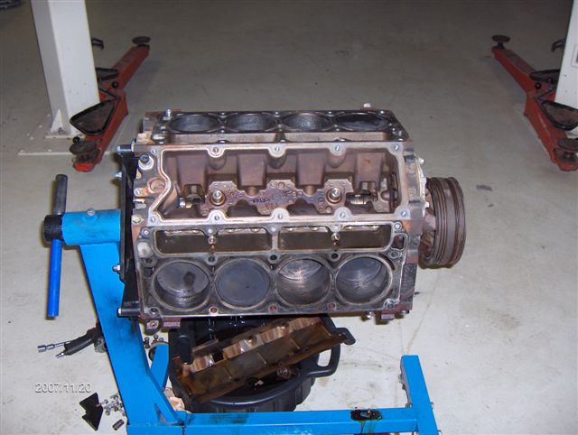

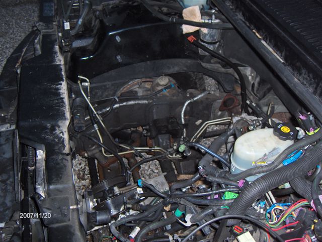

Hi Guys
Thanks for all your help so far. The Hummer have been sitting in my driveway for about 4 month, before the 1 (one) shop in Denmark was able to take it in (there are more shops, but not I would trust my car with)
After I changede the maf sensor --> nothing
Still giving maf sensor error and misfire on 2, 4, 6 and 8.
Changed the spark plug --> Nothing
Then suddenly the computer came on telling me no oil pressure. Checked oil, 1 cm above max ???? I have never put that much oil in it.
Well changed the oil on it, still no oil pressure.
This is what it looks like right now.
The shop tells me that the misfire was because of low oilpresure so the lifters (right word?) didn't open correctly.
Now they have to rebuilt the complete engine.
Any thoughts on what might have caused this, and please don't tell me I have been driving around with little or no oil
Rene

Old 11-29-2007, 07:44 PM
HUMTECH's Avatar
HUMTECH HUMTECH is offline
Location: Canada
Posts: 1,251
HUMTECH is an unknown quantity at this point
Default Re: MAF sensor defect ?
If you are having missfires all on one bank (bank 2 in your case) I can guarentee the right side catalytic converter has too much backpressure causing all cylinders on the right side to missfire. anything above 1 psi is excessive. As for no oil pressure I would check with a mechanical guage, could just be the sender or the gauge in the cluster.
Old 11-29-2007, 08:11 PM
Rene S. Nielsen Rene S. Nielsen is offline
Location: Denmark
Posts: 126
Rene S. Nielsen is off the scale
Hi Humtech
I tried pulling the top of on the right side, no oil. I even tried a manuel oil pressure gauge.
The engine have been running a bit without enough oil pressure, so I need to do a complete overhaul.
But you might very well be right about the right catalytic converter. I will have a look at that.
Is there anyway to test this before I reinstall the engine ?
Rene

No way I know of to check the cat for backpressure unless its running, buy if ya decide to go duramax which is a great idea you will be eliminating the cats anyway.
Old 11-30-2007, 03:57 AM
Takecover Takecover is offline
Join Date: Dec 2006
Location: Huntsville, Al
Posts: 47
Takecover is on a distinguished road
Sorry to hear about your problem! I sure would like to see more pictures of that Elanor Mustang in the back ground on the third picture. It looks great!
