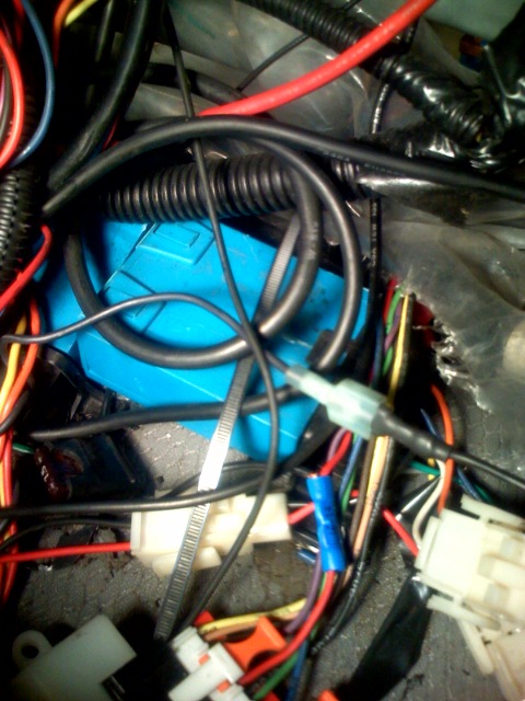

Hello all, I have a 97.5 Hummer with 65,000 miles. I drove it yesterday and it seemed to start and run fine, however when I attempted to start it this morning it wouldn't start. I noticed a strange noise coming from the area behind the glove box where all the electrical cables are. I isolated the noise to a blue box thats mounted by screws underneath all the wires. I'm an idiot when it comes to automotive repair and was just wandering if anyone could give some advice before I take it in and get raped by the dealer for repairs. I'm attaching a photo of the box thats making the strange noise. Thanks for the help, Ryan

Do you have an aftermarket alarm system? Or maybe a remote start? I dont know what that blue box is, and I've got a 97.5. Going on that I'd say that whatever that box is, its aftermarket. FWIW, you've got other accessories under there with some pretty shoddy looking electrical work. You might want to solder and heat shrink all of that, and label the wires.

Thanks for the reply. I kind of feel stupid, I charged the batteries and the truck started fine. I'm assuming the batteries might be going bad or I'm having trouble with my alternater. That whole area under the glove box is a mess, the only accessories I have are an old GPS system and some off roading lights on the light bar. Both were already on the truck when I bought it from the dealer brand new. Once again thanks for taking your time and answering my question. Take care
