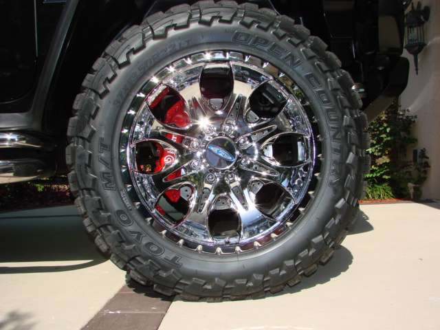

Love the look, but I'd say 15" too wide. I have 37"x13.5" x 22"and have no problem with them except with some minor rubbing on a full turn. Front TK had to be adjusted to accommodate the size, but still no problems. BRUTE

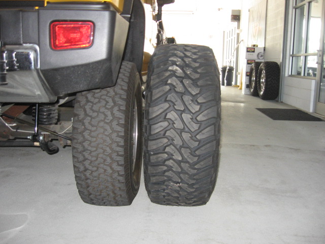

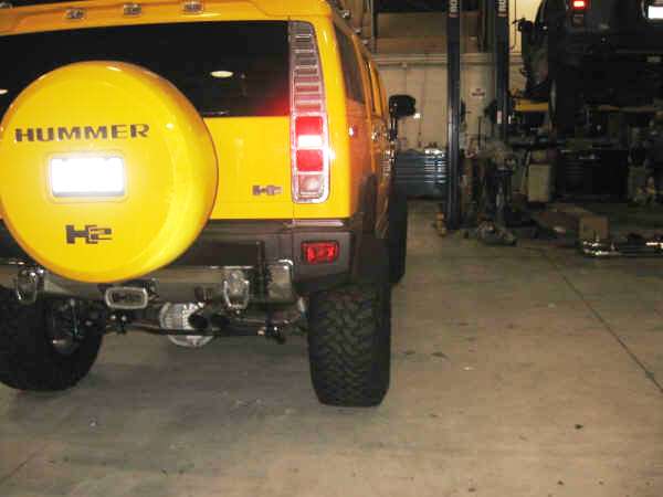

Here is a 37 inch, 15.5 width on one of my rigs (does have a 6 inch lift though!) back spacing is 4.5.
Brute, those rims, tires, and painted calipers look SWEET.

I ran a 35x13.50 (specs out at 13.9) and they were a nice blocky wide tire that gave my truck a really nice wide stance. Im not running a Kumho 37x13.50(specs out at a measly 12.50) and they do not give near the stance so i know what you mean. I broke idler and pitman arms wheeling with the wide tires but im not so sure it wouldnt happen with stockers. The stress you put on your front end depends greatly on if you wheel the truck.
