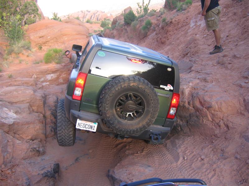

Old 07-08-2007, 07:56 PM
Default Re: ABS , Stabili , and traction
i love that pic
Old 07-08-2007, 08:32 PM
H3slate's Avatar
H3slate H3slate is offline
Sorry for the problems, but great pic!!

thanx , atleast the truck is drivable , i just cant wheel it
