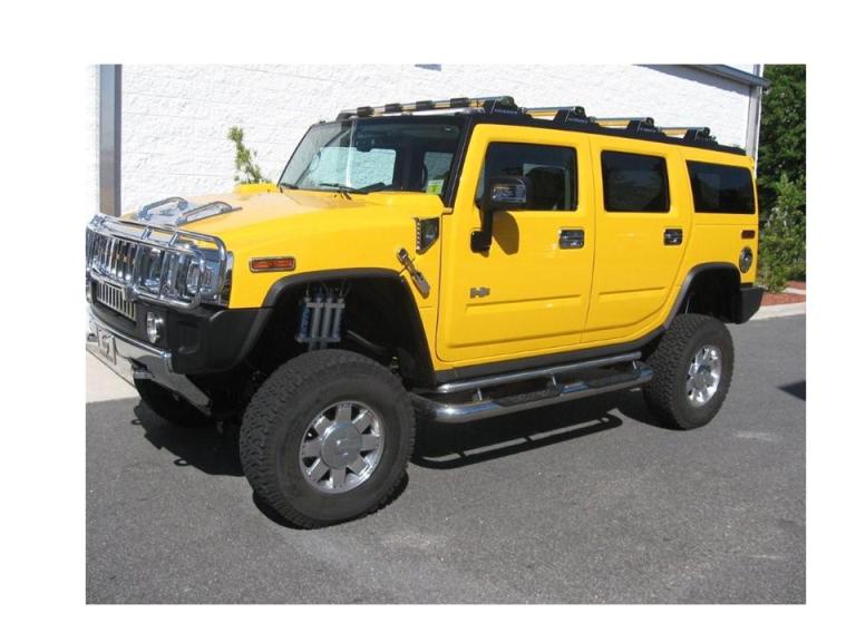

Old 02-26-2008, 05:24 PM
H2R's Avatar
H2R H2R is offline
Join Date: Oct 2007
Posts: 267
H2R is on a distinguished road
Default Re: Track width???
This is what a 6 inch lift looks like with stock tires.

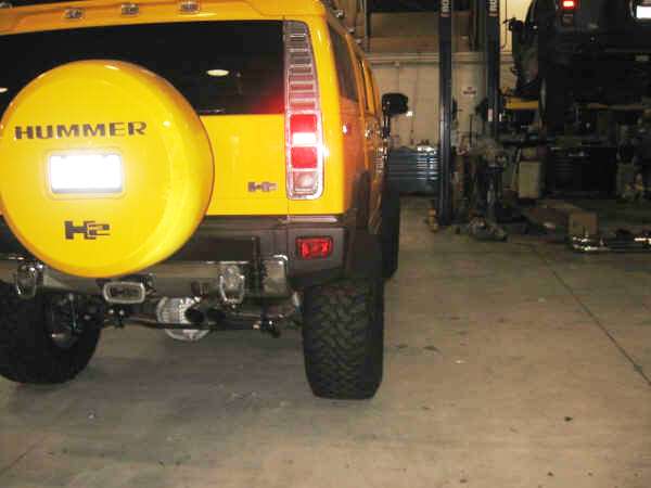

Old 02-26-2008, 05:36 PM
H2R's Avatar
H2R H2R is offline
Join Date: Oct 2007
Posts: 267

here is mine with 5 inch back space
http://www.elcovaforums.com/forums/s...ad.php?t=30234
Some companies that offer lift kits require the diff mounts to be cut among other things. There is much to a lift if you are doing it right. If you supercharge like me and using larger tires, re-gearing is a must to stay in your powerband. The specs on tomps' is right on too. you can keep 15.5 covered with the flair kits out there if your offset is right. Wish you all the luck in your decision.

Old 02-27-2008, 11:09 PM
H2R's Avatar
H2R H2R is offline
Join Date: Oct 2007
Posts: 267
without flairs
