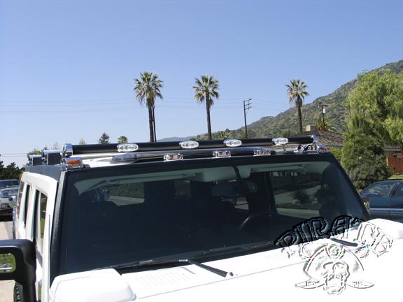

I am debating on purchasing a light bar and found one on the internet for $600.
Here is a brief description (12 Volt, 55-watt, Halogen H3 bulb with a crystal glass lens featuring a multi surface reflector to really light up the night)
Is this bright enough, are there any cheaper alternatives? I dont have a brush guard so I am unable to mount lights there...

IMO, the bar looks nicely integrated. Not bagging on those that have it, but they just don't put out enough light.
You're better talking a factory roof rail and putting an LED light bar(s) or slim Hellas or PIAA lights on it. You'll be much happier with an alternative setup.
I have two bars in silver and two in black if anyone wants a set. We sjust need to figure a way to ship that bar, I can include some destructions on how to mod this up your self.

I have a similar light bar on my truck. The pattern it gives off is a very wide pattern that lights up a trail very well to the sides but not long distance. My bar was $1200 and and it has PIAA's

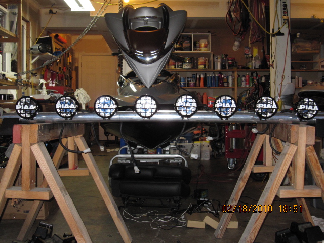

I just fabbed up my light bar using 8 4" PIAAs with extreme white bulbs. I simply replaced the PIAA bolt with a 4 1/2" long bolt, drilled all the way through from front to back and secured each light with PIAA supplied nut on the back side of the light bar. This method gives a little bit of a lower profile light bar.
Here is a picture of the front-

Originally Posted by pdxrealtor
That's exactly how I received mine, wrapped up in bubble wrap. Black pieces were still attaced. The seller shipped them UPS. Hope that helps.
Attachment 52285
Sweet!
What did those lights cost you?

Thanks.
I paid 189.00 a set @ 4 sets. My local auto parts store, baxters, matched the Internet price so that was cool.

The install so far has been very simple. Hardest part for a math retard like me was getting them all equally spaced.
I also took care to keep the natural but slight arc that the OEM bar has.
Honestly I think the amount of bars comes down to personal preference. I will have 4 including the light bar.
I wanted four for the look and the functionality.
You can use the one up front and keep the second, take the second off, get a third, whatever you'd like.
