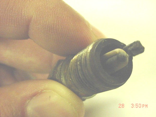

I have a 2003 H2 that has a coolant loss problem. Started to use a small amount of coolant at around 24k miles. Problem has escalated to a loss of about 1/2 gallon every 1500 miles. Have taken the H2 to the dealership several times to address this as a warranty concern, no external leaks have been found. The techs at the dealership have inspected system for gases in the coolant system (dye test / black light), along with pressure testing, ect. It also looks like the rest of the component fluids are clean (engine oil, transmission, ect). Have had 2 dealerships and 2 outside shops look at this problem and no one has a definitive response other than " the coolant is going somewhere." Also had a engine light come on at around 36k miles, turned out to have most of the ceramic insulation missing off of the #2 spark plug (rep at the dealership stated that I needed a fuel treatment before I demanded a plug inspection), have a question in the back of my mind if the 2 problems may be related.
Anyone out there have any thoughts on this? Willing to listen to any thing at this point.

Thanks for the feedback, we checked the new plug on #2 and it looks good (compared to the originals, new plug has been in for around 6000 miles) As far as it going onto the ground, I think that would have been found with the dye and black light test. Still looking.

There was a post here that I don't see anymore( I guess it was deleted) and it made more sense about what is happening than anything else. It was about a cracked or porous intake port runner in the head to a water jacket. Coolant would find its way to the inlet valve then into the cylinder and out the exhaust. Compression would would not get back into the coolant because the inlet valve is closed then, so combustion gases won't be present in the coolant. Here is what you do to check:
1- get the engine hot (fully up to temp) then stop it.
2- pull #2 sparkplug, pull the valvecover for #2 cyl and turn the motor till intake and exhaust valves are in overlap (both valves partially open)then pressurise the cooling system to about 15lbs
3- wait and watch (you should see coolant in cyl with a borescope- wait long enough it will fill up and run out the plug hole!)
coolant is finding its way into #2, but compression is not going back into the cooling system. That is why the insulator broke on the origional plug (from water in the cyl) and why the new plug stays clean. The same could hold true for an exhaust runner also, but I would suspect an intlet leak because of the plug problem.

Don, Thanks for the procedure, I am going to get with a third party mechanic ( I do not have the bore scope) to see how soon we can pull this off. Seems like a damn good direction to head with this as another point of verification / elimination!
I am also going to try to get a decent picture of the plug for this string. Have been told that if I can direct the GM tech to the exact source of problem (pictures, ect) I may have a leg to stand on.

Don, serious question here. Why would that cause the insulator to break?

Here is a pic of the #2 plug.
