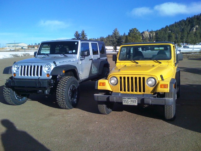

So a got a JK a few weeks ago. One week and 50 miles after I picked it up I started the modification process.
Stock Photo. I still say that a stock JK looks ridiculous without a lift and some bigger tires. I'm not a fan of the bumpers either, so those are on there way out.

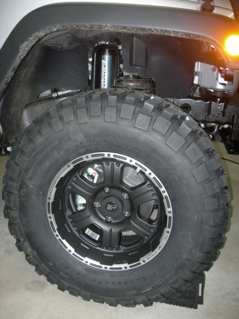

I spent the next weekend installing a Full Traction Ultimate 3" lift.
Added New wheels - Procomp 7189s 17x9
Added new tires - BFG KM2s 35x12.5x17

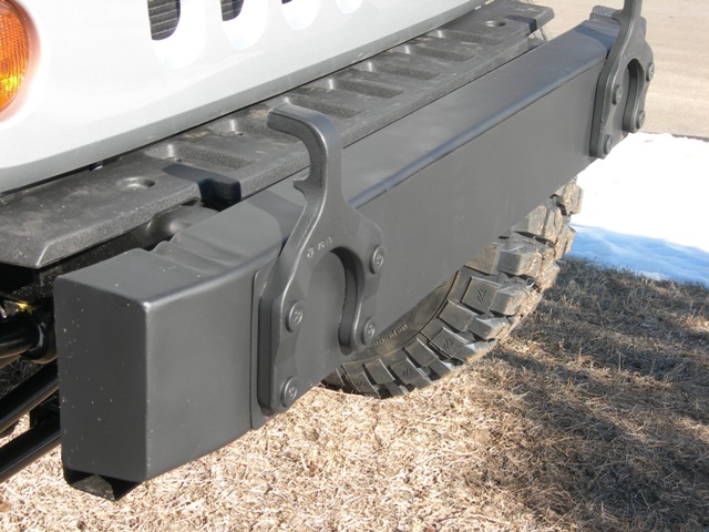

Then, we did a temporary afternoon hack job on the front bumper. It was to lame to drive it around with that stupid mini-van stock bumper. I have new Shrockworks bumpers on order, but they take six weeks.
This will suffice until it arrives. The front bumper is the underlying metal from the stock bumper, trimmed to the size of a stubby bumper. I welded end tabs on the sides and a flat sheet of metal to the front to cover the holes. Then painted it black.

Stage 1 - Complete.

Comparison to a stocker.

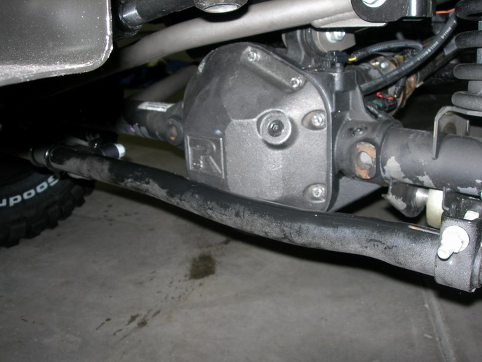

Most recent thing I did was to replace the whimpy Dana 44 diff covers with Riddler 1/4" thick covers. I switched to Royal Purple gear oil in the process.
front
Old 02-12-2008, 03:48 PM
Default Re: A proper build up thread......JK
rear

You need D-rings.
Old 02-22-2008, 01:33 AM
Should be easy enough to flip back over.

You need D-rings.
I agree.......
Although the hooks you did look nice and beefy...they look goofy....
Just my opinion. I like EVERYTHING ELSE about it...
Old 02-22-2008, 11:53 PM
I agree.......
This bumper is only a six week temporary one. 4 weeks ago I ordered a front and rear bumper from Shrockworks. Should be here in about two more weeks. And yes, it has D rings. I'm going to put my warn 9.5ti on when I install it.
