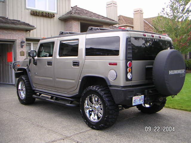

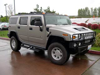

So, just got back from my local GM dealer. I had them check the rear suspension squat issue, and even gave them a print-out of the correct z and d height measurements as well as instructions on what to do with it. They said it was all within normal. He measured the z height and that was fine. I asked him about the d height, and he said that he just measure from all the pivot points to the ground and they were all even, and they even put a level on top of the vehicle, and said it had a slight forward rake. So I asked him about the d height measurement, and he said that there was no fix for the rear, and if I wanted to bring up the front, it would really look funny. (i never questioned the front height...) So I'm back at square one.
Has anybody put shims in above the sensors as a fix? I figured if the sensors were dropped a little, then it would raise the suspension height. Either that, or take it 3 hours to the nearest hummer dealer, and hope they'll fix it...
I guess, last resort...buy a new one?

Hey Doc, I'm going to Bellevue soon to get my front end lowered. They lowered it on my Pewter H2 under warranty. Basically they made sure the gap between the top of the tire and the fender arch was the same all around. When I first bought the rig the front gap was two inches higher than the rear making it look like a squatting lowrider. I hated that look.

After they fixed it, the car looks more level

There is a simple procedure we can do at the dealerships to learn your trim hieght at pretty much any height we want. The only problem is that most of you seem to have dealerships that are somewhere on the scale between idiots and morons. If your dealership seems to have a clue to what's going on, then just tell them that you think the rear end looks low, and even if it is within gm's specs, you would be very happy if they could recalibrate the rear trim hieght to a couple inches higher.

Mine must be idiots, because they insisted that there was no fix for it. I spoke with one of the local tire shops, and they say that they've adjusted the sensors before to level out a ride...but not specifically to raise or lower the vehicle. Do you have instructions on the recalibration that I can give to the dealer to see if they would be willing to do it? I do know that my d height is about an inch low.....

Hey was reading this thread and thought, since I cranked the torsion bars for my 37's the rear appeared a little too low. Rock rail was level but the gap between the tire and the fender well looked smaller in the rear.
So, I went to the dealer and asked them to raise the rear. The tech did not know at first that the front was higher frome the torsion bar adjustment. Anyway he was able to raise it 1.5", said the sensor max was 2.87volts and mine was up to 2.82. Stated that if you go over the 2.87 max then it will set off a code. The 1.5" helped, Looks a lot better. Everyone keeps asking what lift I have.
