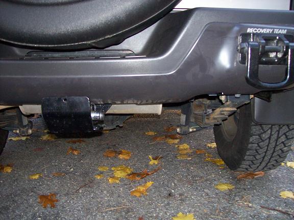

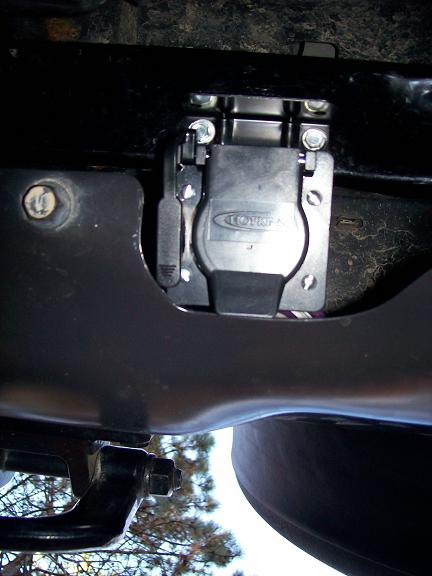

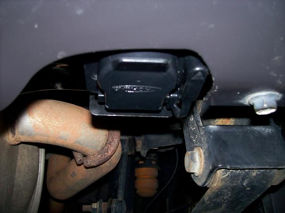

Hitch and wire plug installed ( I mounted the plug upside down behind the bumper I thought it might get damaged hanging near the hitch)
I will pick up the electric trailer brake this week.
The trailering brake looks like easy install theres a Dk blue, Lt blue,+ and - wire under dash.
The problem is were are the wires I need for the back?.
I thought the rear cluster had all 7 wires,there are ony 4 ?
I need the blue electric brake wire
I need the reverse wire
I need a power lead ( I assume this is a full time positive)
Were do I find these,I thought the blue one went to the back ?
any help would be great.

Default Re: Under bumper Hitch options
Well, since the first 2 go to yor tail lights, that might be a good place from where to begin tracing them. There is probably a dummy plug in your power distribution lock (under the hood) which, when replaced with an actual fuse, will supply +12v through the existing wiring. If not, run your own. Just be sure to fuse it.
Old 11-24-2007, 11:10 PM
fourfourto's Avatar
Thanks
Does that blue wire from the front go to the taillight brake light
I thought there might be wires back there caped off that I could use.
Old 11-24-2007, 11:35 PM
tower's Avatar
tower tower is offline
Location: Westwwod, CA.
Posts: 2,501
Very clever!
Thanks
Yes and if you pull the tail light, all will become clear. Also, use a test light to make certain that you have the correct wire.
There may be. I have never torn into an H3. If you pull the tail light, you can trace your way to it. Again, use a test light to make certain that you have the correct wire. Questions are always welcome. Good luck and let us know how it goes.
