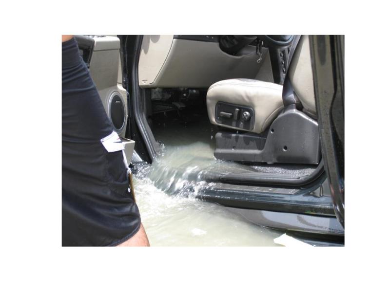

At least your roof didnt leak this bad! I agree just put some compressed air in the drain tube and blow out the obstruction.
