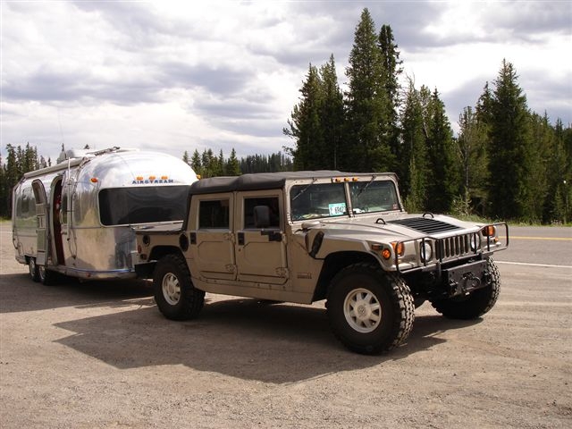

Per request I'm uploading a picture of the H1 towing the Airstream, taken at the continental divide in Wyoming.
As a side note this trip taught me that there are two groups of people in the U.S. Those that came up to me to talk about the Hummer, and those that came up to me to talk about the Airstream.

AWESOME!!!! I need to get one of those!!!!

THANKS FOR THE POST! What an AWESOME picture! Now I've to the bug to hit the road with my H2 and do a road trip to Canada before it gets too cold. A friend tells me the leaves are turning on the trees earlier than ever in the Yukon.
