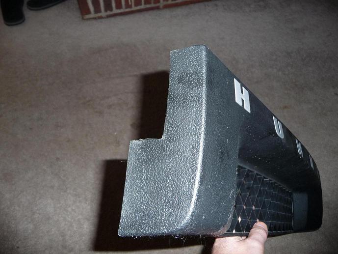

The '08 grille switches out with no problems as long as you switch both the main grille and the lower black plastic grille portion. I had to cut a small section off the sides of the lower piece to allow room for the grille guard to mount but it can't be seen once mounted.

Without a brushguard it should fit just fine w/ no cutting.
