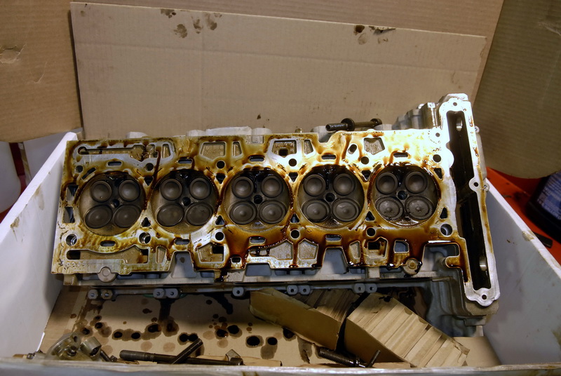

Have the dealer run your vin and see if yours was in the batch that had poorly hardened valve seats or guides or both or whatever they did wrong. That might be it. Those are all the symptoms and they will not go away if that is it. It usually shows up before that many miles "if" that is the problem.

I'd say it is the cylinder head!
Take it to the dealer and get it fixed if that is the problem.

Like Ryan said, get them to do a leak down check. That was how they confirmed my problem. They have done several at the small dealership I go to.
