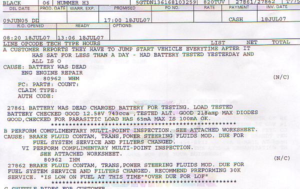

pretty disapointed with what they said. but so far its working we will see what happens tomorrow morning. here is what they said:

wannabeH3 - thanks for the scan. It really made it easy to see what they did do and SADLY couldn't do. How has it worked out these past few days since your visit?
