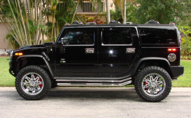

I'm running 37" Toyo M/t's with 22"x12" Moto Metal wheels and, yes, I did add Brembo Brakes. I never had a problem with the oem brakes and never any brake dust. The Brembo's do provide stopping power a lot easier than the oem brakes, especially with the bigger tires and wheels. However, since I do the car show circuit, I am constantly plagued by lots of brake dust and squealing from under 5mph. When I called Brembo, they told me to expect it since these are high performance pads..For what it's worth, I should have stayed with the oem brakes. I know I would have been happier, besides not having to spend all those $$$$$..They do, however look great and for a show car, that's what it's all about..An expensive lesson learned..BRUTE
That is one of the best looking H2's I have ever seen! Goood work. The brakes might not be worth the money, but DAMN they look GOOOOOOD!
